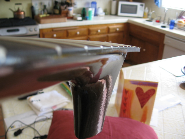

When I did my first fretboard I installed the frets before gluing the fretboard to the neck causing a large backbow in the fret board that was transfered to the neck (It is just now relieving itself).
This time I glued the fretboard to the neck first, put a little backbow in with the truss rod, leveled, THEN installed the frets and ended up with a VERY flat neck except, of course, for the last, unsupported frets. LOTS of bow in the last fret area.
I've seen all the great ideas that include supporting that last area and truly understand the logic but what are some options at this point to alleviate that bow before or during neck installation?

It's only a hump if the fretboard 'humps' on installation. Right now, it's only a dropoff caused by compression by the fret tangs. How easily can it get 'pushed' into the right position?

[QUOTE=Mattia Valente] It's only a hump if the fretboard 'humps' on installation. Right now, it's only a dropoff caused by compression by the fret tangs. How easily can it get 'pushed' into the right position?[/QUOTE]
Not too bad Mattia. That's what I'm thinking is that upon install I can make sure it gets as flat as possible on the body.

[QUOTE=Hesh1956] I get that every time also and if it is not to bad, yours does not look to bad from here, it will straighten on on neck installation.
Also, I recently started pressing my frets and found that there was far less compression and a much straighter fret board.[/QUOTE]
Thanks Hesh, I'm just so gun shy about the fretboard after my last guitar which came close to being unplayable with the back bow.
Pressing the frets seems like such a luxury and I suppose it could be done after the entire fretboard is installed and leveled - again what a luxurious concept. The hammering thing is such a grind and I can't imagine how one would hammer in those last frets AFTER Neck install.
